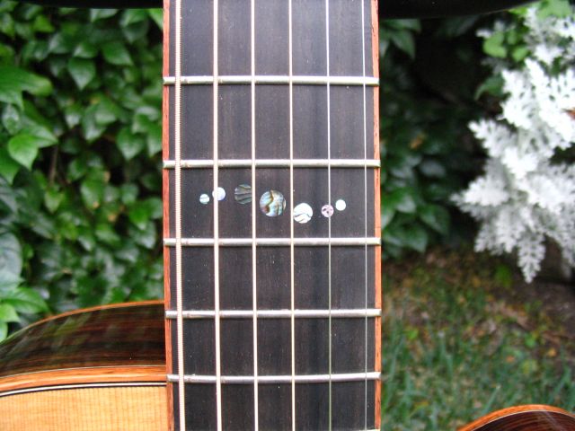

I ordered a bunch of stuff from the U.S. for a trial run of 4 mandolins that I'm going to have built down here and then export to the U.S.. I'm also working on doing the same things with guitars, and with the confusion of multiple orders from multiple places I realized yesterday I didn't buy any pearl dots for my mandolins. I've got abalone for the guitars, but they're much too big for a mandolin fingerboard.

I made my own abalone dots by gluing small pieces of abalone onto the shank end of a brad point drill bit with some CA. Put the drill bit in a drill press upside down. Used a squared off sanding block with 120 grit on one edge to sand the abalone to the same diameter as the drill - on a low speed. Soaked the end of the drill bit in acetone for a few minutes, and popped the abalone off with a thumb nail. Then used the same drill bit to drill the hole to inlay the abalone into - perfect fit every time, any size you want, out of any material you have to hand.
PostPosted: Fri Oct 28, 2005 6:10 am
Hey, Paul...Brilliant! I don't have any need for that technique right now, but it's one of those creative solutions that's so simply elegant that it will stick in my brain for use when I do need it. Thanks!
